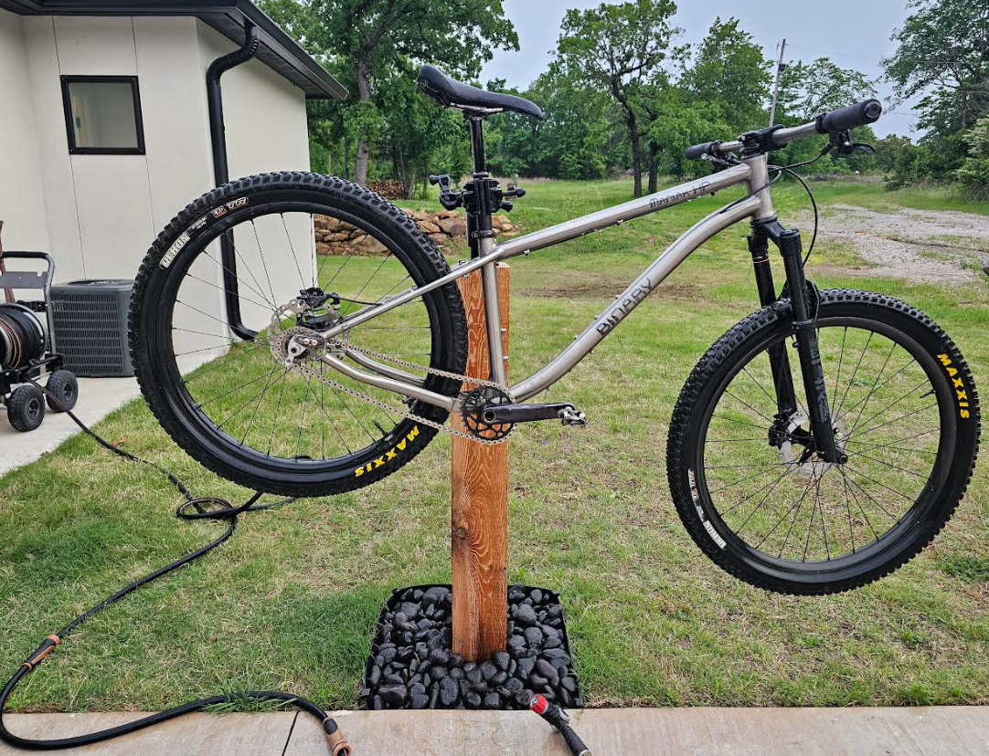

I have 2 stands that I use regularly. My dedicated wash stand outside is a Park Tool PCS-12.2 that I have mounted an a cedar post. My main work stand in the garage is the spectacular Feedback Pro Elite. In both cases, and across 5 regularly serviced bikes (3 carbon, one steel, one Ti), and with various amounts of post lengths sticking out, I always clamp to the post. I've heard some folks don't like to clamp to dropper posts, but I've done it 10,000 times to a number of different droppers with no issue.
Here's that sweet dedicated wash stand:
