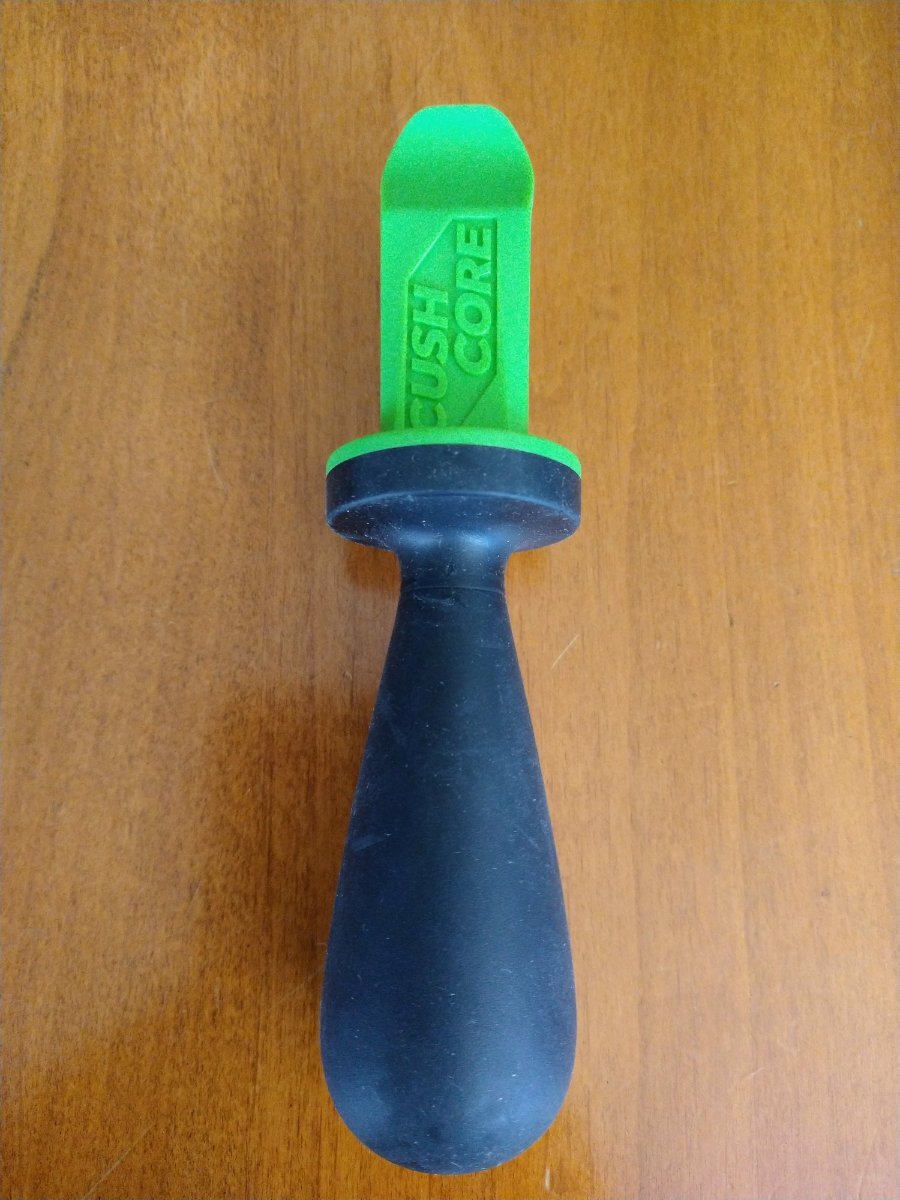

Embarrassed to admit, I broke down and bought one of these🤣
19 minutes ago, ATXZJ said:
What tires are you installing? Also what width rim?
I found installing the tire without the insert and pumping that fukr up to 40 psi and leaving it overnight helps, a lot. The next day it'll be much easier to get the insert in.
It's another Conti Mountain King Shieldwall 2.3 on 30mm internal rims. It's the last one I have in stock and will be switching to something else in the future. Definitely going to see if I can get it on without the Rimpact today, and if so, will do as you suggest and see if I can stretch it out a bit.
Looks like one of those "found on the SATN" items.
